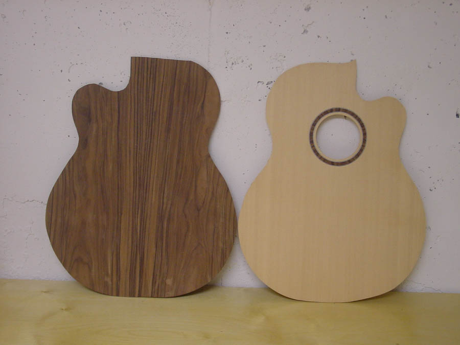

I’ve been planning my next build, and wondering about the several possibilities in choices of wood.
I got this pre-braced top and back set at the swap meet, and I thought why not finish her up.
I thought at first, the obvious choice for the sides should be the same species as the back, which is
Pau Ferro. Lately though, I’ve been thinking of maybe trying something different. For instance, if
I use a mahogany neck, would mahogany sides be complementary? Also, for something really
different, I’ve got a set of bubinga sides, that would be quite the contrast. I suppose that if I go
that route, it would require a very carefully selected appointment scheme.
I would very much like to hear from anyone who has an opinion about this!
The following pics are the set in question, maybe it’ll help.
Robert
Thanks for Looking!

I agree with Hesh here.  If I had a pre-braced top and back like you have, I would consider it a perfect candidate for experimenting.  I would either go with mahogany to match the neck, or go with something totally different to make it look very unique.  Either a very light or very dark side wood to make it contrast.  I am thinking something like Maple or Walnut.  Heck, I might even consider Bloodwood, Padauk or Camatillo to add some color.  I would definately play with it to make something very different!
PostPosted: Tue Jul 03, 2007 11:42 pm
Well, I'm always leaning toward mahogany as a neck wood regardless of the back and side woods. I think it would look fine with that b&s set.
You will start to realize that the aesthetics of what look good are purely subjective, and have little to do with how good an instrument is. Although, as it turns out, many folks tend to like the same things aesthetically.
More importantly, you want to just build something, and pay close attention to what you're doing as far as the sound and the setup/playability.
Remember, the design "3F's" standard is "Form Follows Function". Concentrate on making a good guitar, and worry less about how pretty it is at first.

Robert...From the above pic, I would go with the Mahogany rather than Bubinga. To my eye it compliments the Pau Ferro better.

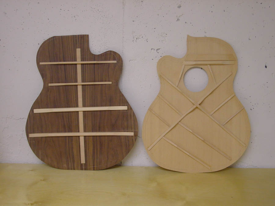

One other issue to consider. Many builders feel that the braced plates should be glued to the rims as soon as possible after bracing. The idea is that the plates can lose their dome if left unconstrained. Then again, I've seen shop pictures where other builders have a significant number of braced tops and backs made up in advance and just lying around. Having actually experienced a back losing its dome, I now glue them to the sides as soon possible after the bracing is completed. As a rule, I make up the sides and have it all ready for gluing as soon as the plates are braced and voiced.

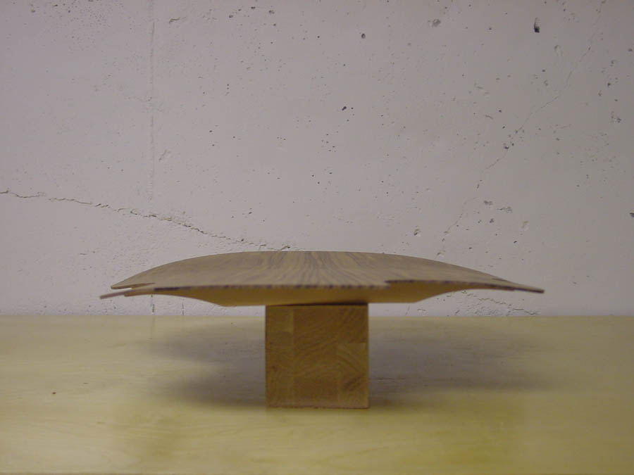

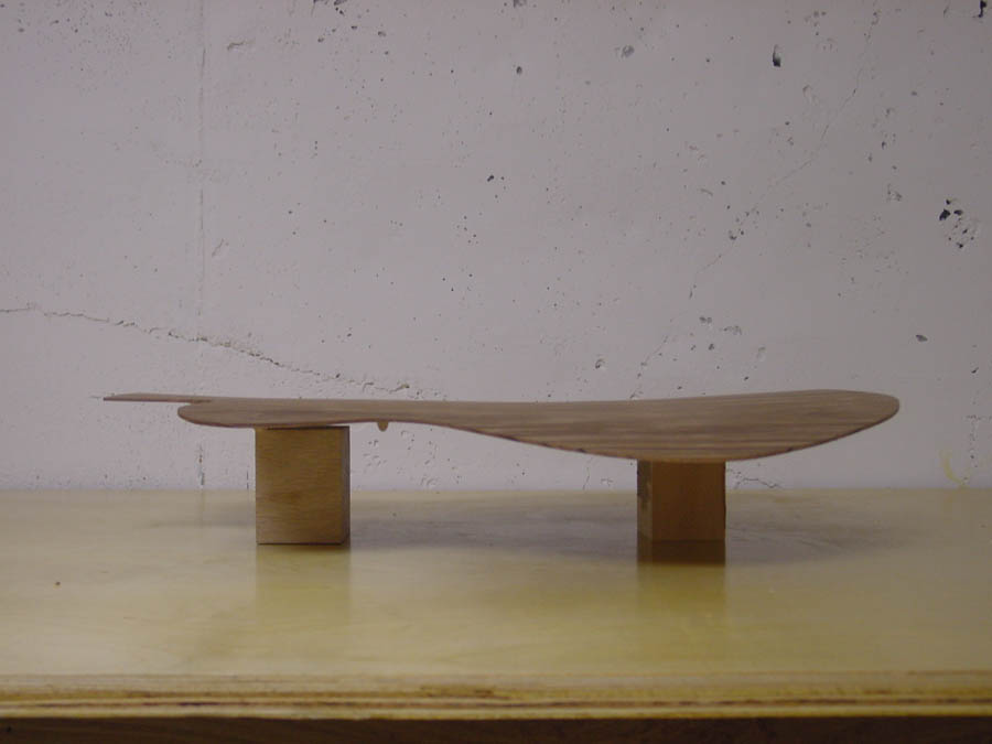

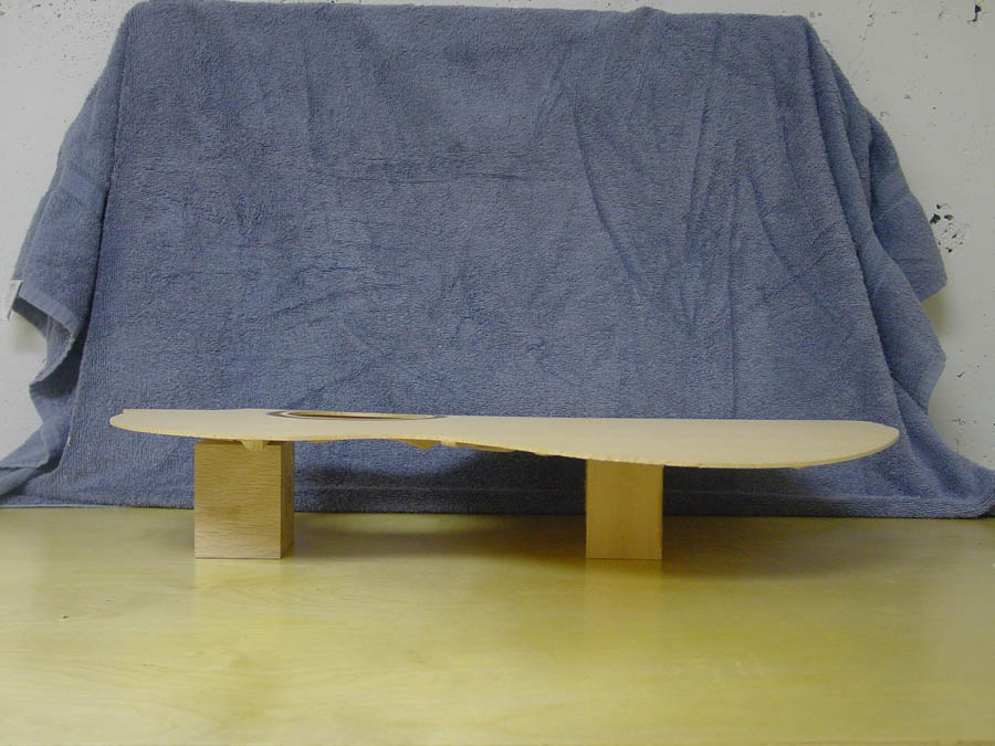

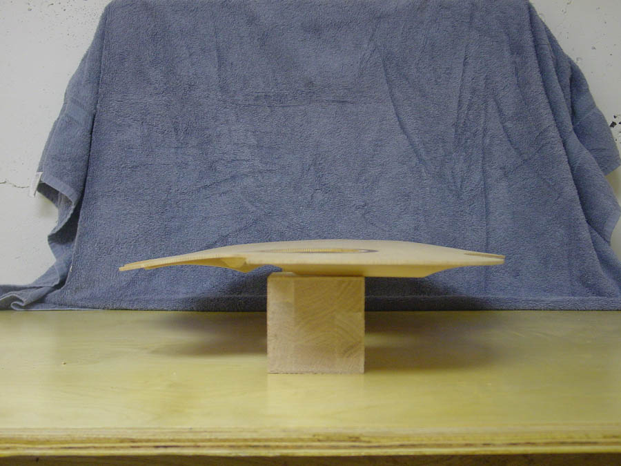

Also, it has been mentioned, the possibility of losing the dome. Here are some pics that show the
condition of the back & top.
I would welcome more comments on the following pics as well.

Wow. Someone has humidity control issues...
What does your shop humidity measure out at?
Looks to me you're going to have to pull off all those braces, get the wood flat again, and re-brace after you get a rim made to put them on.

Right now, my humidity meter is showing 85%. It’s been around 75% for some time now.
Do you really think something as drastic as you suggest is necessary?
If that’s the case, I may just set this set aside for another day.
I’ve got a lot of other wood I can use that has not been braced,
and is very flat and striaght!
Robert
